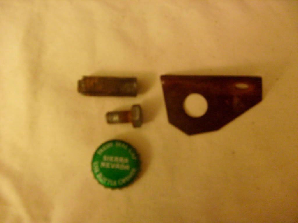

Well I had to miss the big show on saturday which I bet was a blast, made it to the west side on friday which was perfect temps and big flowers all over the place.  Wandered on up to Tombstone to do a few routes, the regular route then Doc holiday direct.  Stopped at the lonesome bolt on the route and thought a new bolt was in order due to it spinning, creaking, and making my grade for a full on death bolt.  Placed a Stainless Steel 3/8 x 2.75 inch with SS hanger exactly 4" below and 5 " to the right  in the hardest rock I've drilled in pinnacles (Bomber).
 The loadstone the original was placed in was fractured on the left and with some inspection noticed the stone was not solid.  I checked the possible clipping stances prior to placing the bolt and its placement does not affect the clip. Removed the original bolt which was a 3/8 x 1/2 Rivet. Then came the expansion sleeve which was 1/2 inch in diameter (never seen this type), it pulled out with a couple of light hammer taps.  The original hole is 1/2 in diameter and 3/4 inch deep.  Made a crude patch with munge and sweat which worked great.  Here's the pic:

killer, thx Mucci
that thing is tiny

Yeah you can see it was only in 5 threads from the rust accumulation.  Has anyone lead this before?

ulgh......don't lean back.

Nice work, Josh. Yes, I've lead it. I could find the date in my journals, but probably in the early 90's. Looking at your report, I think I'm glad I didn't know what the "protection" really was as I led the route. Sheesh, why even bother putting in such an illusion of protection!

Why bother.....good place to hang your rack and lighten things up on the way up ::)

I led it back in 1993.  I was under the impression that there was another bolt.  It was too late to go back when if figured out that one pissant bolt was it.
