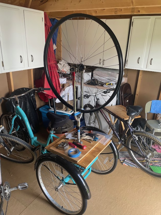

I bobbled on a mount the other day and fell forward just enough to rake the pedal up the back of my leg.
I've been having trouble with the 36 inch wheel for months. After replacing the tire (to no avail) I began hypothesizing that something must be bent. Thus far I have replaced every part except the frame (tire, pedals, cranks, rebuilt wheel, seat post, seat). In the process, I learned how to lace and true my wheel (new hub, bearings and new spokes). I'd order a frame but it turns out I won't be able to get one until next year. In the interim, in an attempt to eliminate myself as the cause of the riding difficulty, I ordered a 26 inch wheel (what I learned on) and started riding that. Now, trying to ride the 36er feels even more foreign - something I have not experienced in the last decade of riding it. WTF?
I am determined to figure it out and have even started thinking about ordering a 29 inch wheel to see how that feels.

Do you have one of those stands to true your wheel?  I guess you could flip the unicycle upside and throw it in a vice or something.
Recently bought this book about wheels an wheel building by Jobst Brandt.  https://www.isolapress.com/shop/jobst-brandt  Might have posted here before but his other book is really cool too. A lot of photos of riding on the Peninsula and Santa Cruz mountains pre- MTB.  Also some good photos of riding Sonora Pass in the 70s.  I highly recommend both his books. Looks like the publisher has some other cool titles that I have not bought yet.

There are no truing stands for 36 inch wheels but the frame works. I just took the seat off and screwed the seat post bracket to a couple pieces of scrap plywood and then used zip ties for side to side and painters tape for up/down. Lacing the wheel was a trip and I did buy a spoke tension meter from Park Tools. I tried a cheapie first and it was junk.
