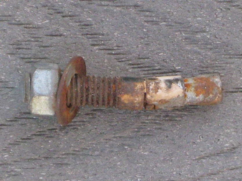

The old 2nd bolt was also a time bomb/accident waiting to happen (I'll cross-post on the rebolting thread). It was a 2 1/4 inch long wedge bolt that was bent by too much hammering into an underdrilled hole and the cone never engaged the clip. The only thing holding it in was the two little bumps on the sides of the clip. It was pointed down (no shear strength) and pulled out with disturbing ease.
The old bolt
You can see how bent it is and the lack of any clean metal on the cone - no engagement of the clip.
The replacement bolt

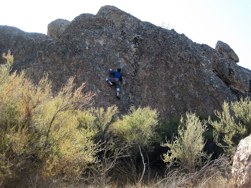

Wednesday I replaced the lead bolts on April Fools Route (on Papa Bear) and then just had time to try it on TR before sunset.
It's a highball boulder problem with a tough/thin/tricky upper section past the 2nd bolt.
Nice rock, cool moves but super runout/bold (old Higgins route - April 1976).
Also jazzed about getting that rebolted since the first, critical bolt was a 1/4 inch split shaft (2 inches long) on a Leeper.
The bolts were well placed and both produced a nice "pop" when I cranked down the puller tool.
Here are the old bolts (top bolt on the left, bottom bolt on the right)
and the beautiful replacements
bolt 1 - 30 feet up
bolt 2 - 15 feet above bolt 1
The bolts are no longer hard to see (as described in the guidebook)

Looks a bit short?
« Reply #2046 on: December 05, 2020, 07:16:36 PM »
Looks a bit short?
Thus the name.
It's good climbing if you're out there doing other stuff.

Looks a bit short?
Or that brush is really tall.
« Reply #2051 on: December 05, 2020, 07:55:29 PM »
Or the brush is above the photographer and looks like it is high.

Looks a bit short?
Just for the record it is 37 feet (6 of my pulls which may actually be 6' 2" each) on a direct line from the anchor to the ground.
The climbing is a bit longer though, since the moves lead you left, then back right, then left again at the exit.
The bolt spacing will get your attention.  :devildevil:
